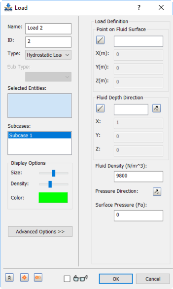

If Type is set to Hydrostatic Load, the dialog appears as shown below.

  1. Set the Load type to Hydrostatic Load and select the surface to which the load is applied.
  2. In the Fluid Density field, specify the weight density of the fluid that causes the pressure.
  3. Specify a point on the top of the fluid, either by selecting an entity in the model, or by using the X, Y, and Z fields in the Point on Fluid Surface section. Only elements below this point receive a hydrostatic pressure.
  4. Hydrostatic pressure can increase along any direction. Define the fluid depth direction, either by selecting an entity in the model, or by using the X, Y, and Z fields in the Fluid Depth Direction section.
    The Surface Pressure section defines the pressure on top of the fluid, such as a pressurized vessel partially filled with liquid. The pressure above the fluid surface is equal to the surface pressure. The pressure below the fluid surface is equal to the surface pressure plus the hydrostatic pressure.
