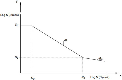

  3. The S-N curve shown in Figure 1 is characterized by the following equations:
    If
    If
    where,
    is the number of cycles to failure
    is the amplitude of input stress (Smax - Smin)/2
    is the number of failure cycles at the endurance limit
    and the slope B shown in Figure 1 is calculated by:
  4. A small slope is required to prevent infinite life. See Figure 1.
    Figure 1. Stress-Life Curve Format
