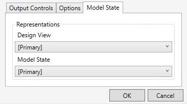

- Model State tab:
Autodesk Inventor Nastran supports Representations defined in Autodesk Inventor. This feature allows you to quickly hide/unhide or suppress/unsuppress parts of an assembly or subassembly.
- Representations:
- Design View: This drop-down menu lists the Design View representations you created in Inventor. In these views, some assembly components are not visible, if they are not needed for a particular view and analysis. Hidden parts still participate in the analysis.
- Model State: This drop-down menu lists the Model States you created in Inventor. In these views, unwanted components are suppressed, or assembly parts are replaced with a single part representation. Suppressed parts do not participate in the analysis.
- Representations:
