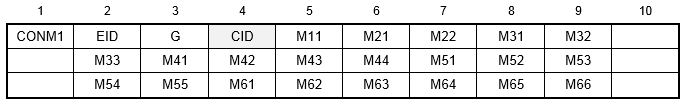

Concentrated Mass Element Connection, General Form
Description: Defines a 6-by-6 symmetric mass matrix at a geometric grid point.
Format:
Example:
Field Definition Type Default
EID Element identification number. Integer > 0 Required
G Grid point identification number Integer > 0 Required
CID Coordinate system identification number for the mass matrix. Integer ≥ 0 0
Mij Mass matrix values. Real Required
