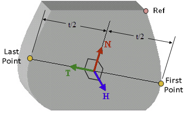

The stress values along the SCL are reported as six stress tensors based on a local coordinate system. Therefore, you need to define the three perpendicular directions on which the tensor calculations are based. These axes are named the T, N, and H. The positive T axis is defined by the direction of the SCL, First Point to Last Point. The Reference Point defines either the
N Axis or the
H Axis direction, depending on which radio button you activate.
- If the N Axis option is selected, a line perpendicular to the T axis passing through the Reference Point defines the N axis direction. The H axis is then defined as the axis perpendicular to both the T and N axes.
- If the H Axis option is selected, a line perpendicular to the T axis passing through the Reference Point defines the H axis direction. The N axis is then defined as the axis perpendicular to both the T and H axes.
- Regardless of the option you select, the N axis is the cross product of the T and H axes, following the right-hand rule.
The figure below shows the local axis configuration if the N Axis is defined:
