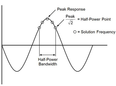

  4. The frequency spread can be used also to define the half-power bandwidth. The half-power bandwidth is given by where is the damping ratio. Therefore, if FSPD is specified equal to the damping ratio for the mode, NFM specifies the number of solution frequencies within the half-power bandwidth. See Figure 1 for the definition of half-power bandwidth.
    Figure 1. Half-Power Point and Bandwidth
