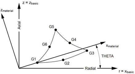

  2. The grid points must lie in the x-z plane of the basic coordinate system, with x = r ≥ 0. The grid points must be listed consecutively beginning at a vertex and proceeding around the perimeter in either direction. If the ID of any edge connection points is left blank or set to zero, the element equations are modified to give the correct results for the reduced number of connections. Corner grid points cannot be deleted.

  5. Material properties (if defined on a MAT3 entry) and stresses are given in the coordinate system shown in Figure 2.

Figure 1. CTRIAX6 Element Idealization
Figure 2. CTRIAX6 Element Geometry and Coordinate Systems
