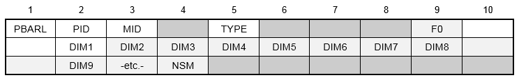

Format:
Example:
Field | Definition | Type | Default |
PID | Property identification number. | Integer > 0 | Required |
MID | Material identification number. See Remark 2. | Integer > 0 | Required |
TYPE | Cross-section type. Must be one of following character variables: BAR, BOX, BOX1, CHAN, CHAN1, CHAN2, CROSS, H, HAT, HEXA, I, I1, ROD, T, T1, T2, TUBE, or Z. See Remark 4. | Character | Required |
F0 | Preload. | Real or blank | 0.0 |
DIMi | Cross-sectional dimensions. | Real > 0.0 | Required |
NSM | Nonstructural mass per unit length. | Real or blank | 0.0 |

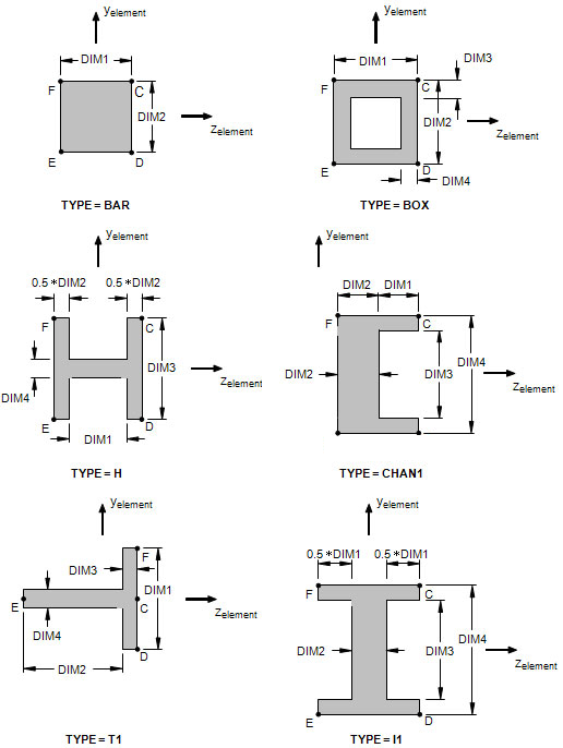

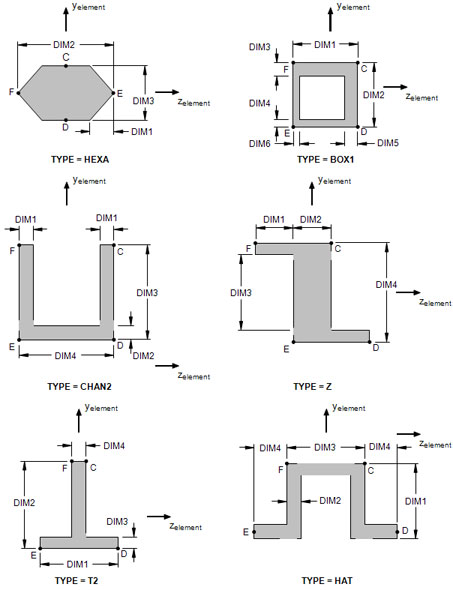

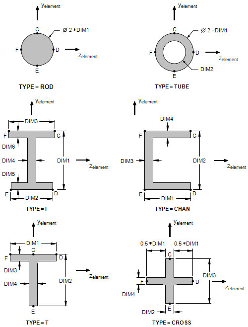

- The cross-sectional properties, shear flexibility factors, and stress recovery points (C, D, E, and F) are computed using the TYPE and DIMi as shown in Figure 1. The origin of element coordinate system is centered at the shear center of the cross-section oriented as shown.
Figure 1a. Definition of Cross-Section Geometry and Stress Recovery Points
Figure 1b. Definition of Cross-Section Geometry and Stress Recovery Points
Figure 1c. Definition of Cross-Section Geometry and Stress Recovery Points
