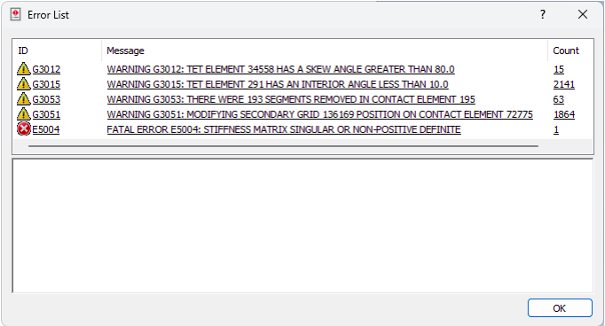

Use the Error List to view all errors and/or warnings after the analysis has been solved. The Error List can be accessed from the Solve panel on the Inventor Nastran ribbon.
It can also be accessed directly from the Solution Finish dialog.

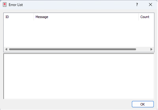

The following dialog opens:
Upon completion of the analysis, whether it solves with or without errors and warnings, the Error List dialog can be launched from the Solution Finish dialog by clicking on "View Warnings" or "View Errors". This provides a list of warnings and errors that occurred during the solve. By clicking on these warnings and errors, you can access more detailed information about the issue in the bottom section. Guidance on how to resolve some of these issues is also provided.

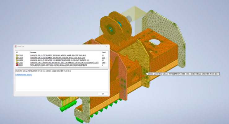

For warnings that may be related to the CAD or FEA entity of the model, they are highlighted on the canvas with a tooltip. Double-clicking on the errors or warnings will direct you to an online help page.
You can also select the "Troubleshooting actions" link in the bottom section to access online help.
