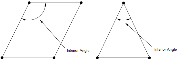

Figure 1. Interior Angle Check.

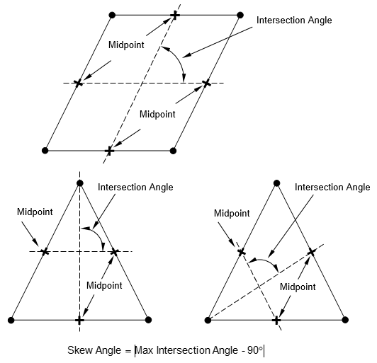

Figure 2. Skew Angle Check.

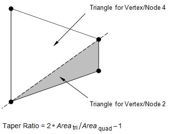

Figure 3. Taper Ratio Check.

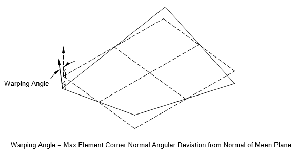

Figure 4. Warping Angle Check.

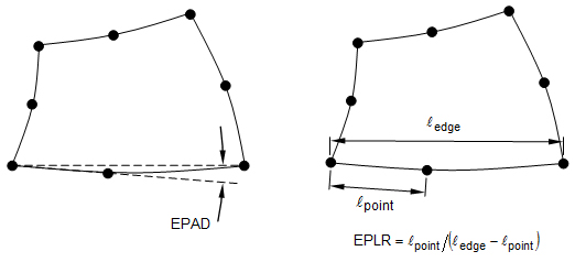

Figure 5. Edge-Point Angular Deviation and Length Ratio Checks.

- Interior angles are defined to be the angles formed by the edges that meet at the corner node of an element. There are four for quadrilateral shapes and three for triangular shapes. A perfect rectangle would have four 90 degree interior angles. An equilateral triangle would have three 60 degree interior angles. Internal angles are evaluated against both a minimum and a maximum tolerance. Like skew, large and small internal angles result in poor element performance, especially as they approach the upper and lower default limits of this check. And internal angle of 180 degrees or more will result in a singular element. An internal angle of zero degrees is also singular.
Skew angle for a quadrilateral element or solid element face is a measure of how much of a parallelogram it is relative to a rectangle. It is defined to be the angle between the lines that join midpoints of the opposite sides of the quadrilateral minus 90 degrees. A rectangle would have a zero skew angle. Skew angle for a triangular element or solid element face is a measure of how close it is in shape relative to an equilateral triangle. Skew angle for the triangular element is defined to be the angle between the lines that join midpoints of two opposite sides relative to the line through their vertex and the midpoint of the remaining side minus 90 degrees. An equilateral triangle would have a zero skew angle. Each vertex of the triangle is examined and the largest skew angle reported. Element accuracy can be sensitive to element skew angle.
- Taper ratio for the quadrilateral element is defined to be the absolute value of (the ratio of the area of the triangle formed at each corner grid point to one half the area of the quadrilateral minus one). The largest of the four ratios is compared against the tolerance value. Note that as the ratio approaches zero, the shape approaches a rectangle. A large taper ratio implies an element that is trapezoid shaped, with a short edge opposite a long edge. High tapers affect the ability of an element to extrapolate Gauss point values to corner nodes accurately.
- The warping angle is the angle formed between the normal vectors located at diagonally opposite corner points. The warping angle is zero when all four corner points are in the same plane. Quad elements are very sensitive to even small amounts of warping and users should keep elements as flat as possible, breaking them up if necessary to prevent warpage.
- The edge point length ratio and edge point interior angle tests are only performed for solid and shell elements when edge node points exist. The length ratio test evaluates the relative position of the edge node point along a straight line connecting the two vertex nodes of that edge. Ideally, the edge point should be located on this line at a point midway between the two end points. The edge point angular deviation is the angle between the lines joining the edge node and the end points. For curved elements, some angular deviation is necessary and expected, but high values will compromise the stiffness of the element.
