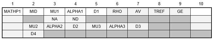

Hyperelastic Material Properties, Ogden Form
Description: Defines material properties for use in fully nonlinear (i.e., large strain and large rotation) hyperelastic analysis of rubber-like materials (elastomers) for isoparametric solid elements.
Format:
Example:
Field | Definition | Type | Default |
MID | Material identification number. | Integer > 0 | Required |
MUi | Shear moduli related to distortional deformation. | Real | 0.0 |
ALPHAi | Exponents related to distortional deformation. | Real | 0.0 |
Di | Material constants related to volumetric deformation. | Real ≥ 0 | See Remark 2 |
RHO | Mass density in original configuration. | Real | 0.0 |
AV | Volumetric coefficient of thermal expansion. | Real | 0.0 |
TREF | Reference temperature for the calculation of thermal loads. | Real | 0.0 |
GE | Structural element damping coefficient. See Remarks 6 and 8. | Real | 0.0 |
NA | Order of the distortional strain energy polynomial function. | 0 < Integer ≤ 3 | 1 |
ND | Order of the volumetric strain energy polynomial function. | 0 < Integer ≤ 4 | 1 |
Remarks:
- The generalized Ogden strain energy may be expressed as follows:
where
and
are principal stretches;
is the determinate of the deformation gradient; and 2D1 = K at small strains, where K is the bulk modulus.
is the current temperature and
is the initial temperature.
- The default for D1 is
. The default for D2 through D4 is zero.
- Hyperelastic materials show a fully incompressible or nearly incompressible behavior. Full incompressibility is not presently available, while nearly incompressible behavior can be simulated using a large value of D1.
- The mass density, RHO, will be used to automatically compute mass for all structural elements.
- Weight density may be used in field 9 if the value 1/g is entered on the PARAM, WTMASS entry, where g is the acceleration of gravity.
- To obtain the damping coefficient GE, multiply the critical damping ratio C/C0, by 2.0.
- TREF is used only as the reference temperature for the calculation of thermal loads in linear solutions. If TEMPERATURE(INITIAL) is specified, TREF will be ignored.
- If PARAM, W4 is not specified, GE is ignored in transient response analysis. (See Section 5, Parameters, for more information on W4.)
