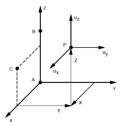

Figure 1: CORD2R definition

- The location of a grid point (P in the sketch) in this coordinate system is given by (X, Y, Z).
- The displacement coordinate directions at P are dependent on the location of P as shown above by (uX, uY, uz).
