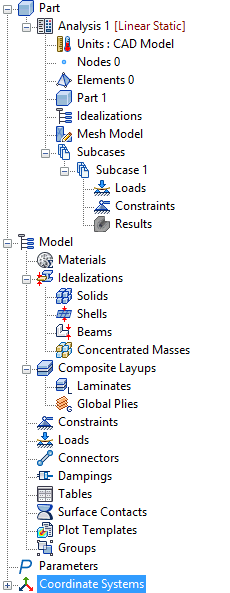

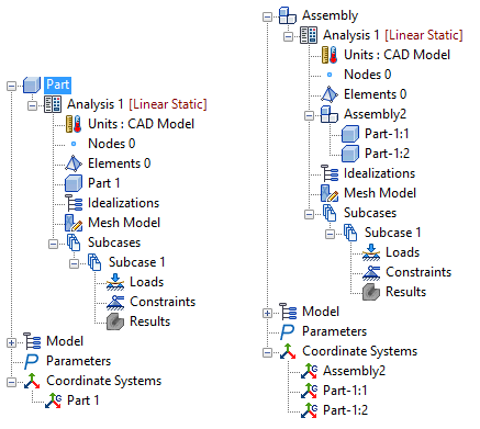

The Autodesk Nastran Model Tree gives a convenient outline view of the various finite element model entities created.
The top level tree items are as follows:
- Part
(Part / Assembly name)
- Analysis
(Analysis name)
- Units (Unit system)
- Nodes
- Elements
- Part/Assembly (CAD details)
- Idealizations
- Mesh Model
- Subcases
- Loads
- Constraints
- Results
- Analysis
(Analysis name)
- Model Tree
- Parameters
- Coordinate Systems
By default the Model level tree items and Coordinate Systems will be in collapse mode.
