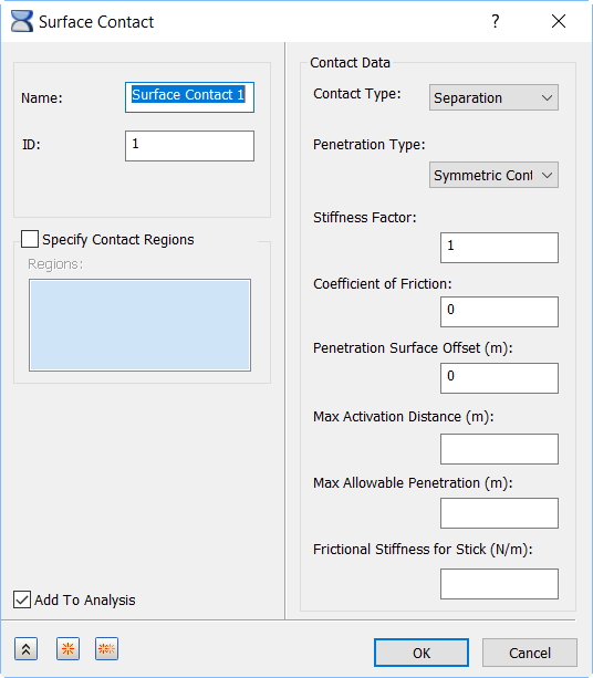

The following dialog opens. The appearance differs depending on whether you clicked the Manual or Solver option:
Manual mode:
Solver mode:
Solver mode for Explicit Dynamics or Explicit Quasi-Static analysis:

The Surface Contact form has the following main sections:
- Name: Enter a name for the surface contact, for example, Top Contact Pair.
- ID: The ID is automatically updated as the contact pairs are created.
- Two types of surface contacts can be created:
- Manual: You specify the Type setting (Surface to Surface or Edge to Surface) and the Penetration Type (Unsymmetric Contact or Symmetric Contact). You also must individually select the primary and secondary entities.
- Solver: The program chooses the appropriate Type setting (Surface to Surface or Edge to Surface), Penetration Type, and the primary and secondary entities. The appropriate treatment is determined based on the geometry and mesh characteristics. The command can act globally (on the entire model), or you can specify the Contact Regions to consider for contact pair generation.
For Unsymmetric contact, nodes on the secondary entity cannot penetrate the primary contact surface. For symmetric contact, the same behavior is true, plus nodes on the primary entity also cannot penetrate the secondary surface.
The other sections in this form vary sightly depending on the type of contact you select (Auto or Manual). Follow the links at the bottom of this page to see more info on the other sections available in the Surface Contacts form.
