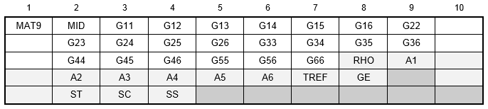

Format:

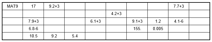

Example:
Field Definition Type Default
MID Material identification number. Integer > 0 Required
Gij Elements of the 6 x 6 symmetric material property matrix in the material coordinate system. Real Required
RHO Mass density. Real or blank 0.0
Ai Thermal expansion coefficient vector. Real or blank 0.0
TREF Reference temperature for the calculation of thermal loads. Real or blank 0.0
GE Structural element damping coefficient. See Remarks 7 and 9. Real or blank 0.0
ST, SC, SS Allowable stresses in tension, compression, and shear, respectively. Required if composite element failure index is desired. Real ≥ 0.0 or blank 0.0

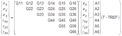

  3. The subscripts 1 through 6 refer to x, y, z xy, yz, zx of the material coordinate system (see the MCID field on the PSOLID entry description). The stress-strain relationship is:
