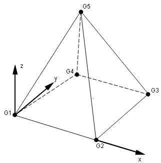

  2. The topology of the diagram must be preserved; i.e., G1, G2, G3, G4 define a quadrilateral face G1, G10, and G5 are on the same edge, etc.

  6. The element coordinate system is defined as follows:
    The origin is located at the midpoint of a straight line joining points G1-G4. The x-axis passes through the midpoint of a straight line joining G2-G5. The z-axis is normal to a plane passing through the midpoints of straight lines joining G1-G4, G2-G5, and G3-G6.
Figure 1. CPYRA Element Connection
Figure 2. CPYRA Element Coordinate System
