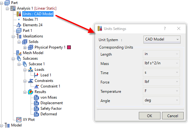

The units selected within the Analysis form are defined only for that specific Analysis. The units are also exported to the Nastran Bulk Data file as PARAM, UNITS, LengthUnit (such as IN or MM).
Once the units are defined, they will show up in the tree under Analysis, and you can edit the unit system from there, as shown in the following image.
The display units are also shown at the top of the legend for results contour plots. In this case, a drop-down menu is provided to quickly switch to alternative display units.
