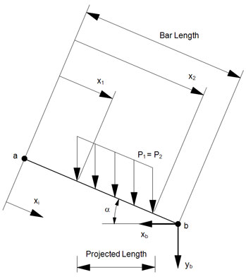

  7. If SCALE = LEPR (length projected), the Xi values are actual distance along the bar x-axis and (if X2 ≠ X1) the distributed load is input in terms of the projected length of the bar.
    Figure 1. PLOAD1 Convention on Bar and Beam Elements
  8. If SCALE = LE, the total load applied to the bar is P1(X2 - X1) in the yb direction.
  9. If SCALE = LEPR, the total load applied to the bar is P1(X2 - X1)COS(α) in the yb direction.
  10. If SCALE = FRPR (fractional projected), the Xi values are ratios of the actual distance to the length of the bar and (X1 ≠ X2) the distributed load is input in terms of the projected length of the bar.
