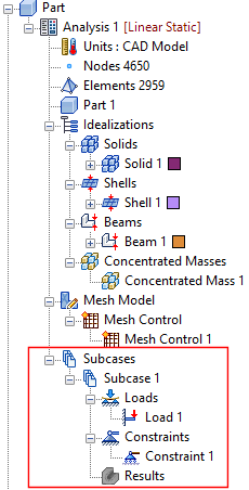

Subcases
This is the next sub-level in the tree under Mesh Model. Depending on the analysis type there are different sub-levels in the Subcases branch.
When you right-click on Subcases, the following options are available from the context menu:
  • New: Creates a new subcase.
  • Paste: Allows you to paste copied items (such as a load or constraint from the Model branch of the tree or a different subcase).
Subcases by default consist of Loads, Constraints, and Results sub-level entities. You can define the loads and constraints directly (using ribbon commands) or from the model tree.
