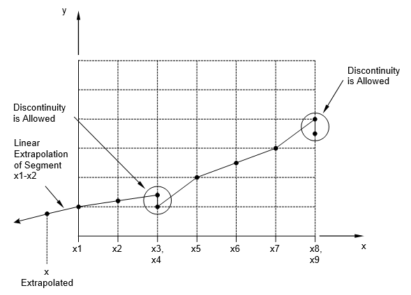

  2. Discontinuities may be specified between any two points except the two starting points or two endpoints. For example, in Figure 1 discontinuities are allowed only between points x2 through x7. Also if y is evaluated at a discontinuity, then the average value of y is used. In Figure 1, the value of y at x = x3 is y = (y3 + y4)/2.

    where x is input to the table, y is returned, and is supplied from the MAT1 entry. The table look-up is performed using linear interpolation within the table and linear extrapolation outside the table using the two starting or endpoints. See Figure 1. No warning messages are issued if table data is input incorrectly.

    Figure 1. Example of Table Extrapolation and Discontinuity
