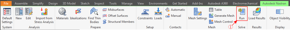

There are three ways to execute the Solve in Nastran command:
- Click the
Run command in the
Solve panel of the ribbon bar.

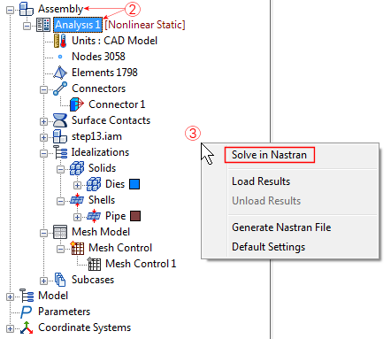

- Right-click the Part/Assembly or analysis name heading ("Analysis 1" in the example below) and choose Solve in Nastran from the context menu.
- Right-click on an empty space of the Autodesk Nastran Model Tree and select
