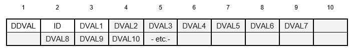

Description: Defines real, discrete design variable values for design optimization.
Format:
Example:
Alternate Format and Example:
Field Definition Type Default
ID Discrete value set identification number. Integer > 0 Required
DVALi Discrete values. Real Required
INC Discrete value increment. Real Required when using alternate format
Remarks:
  1. DDVAL entries must be referenced by a DESVAR entry in the DDVAL field.
