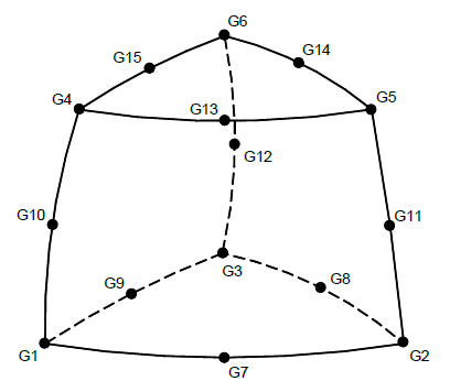

Figure 1: CPENTA element connection

- The topology of the diagram must be preserved: for example, G1, G2, G3 define a triangular face.

- Figure 1 shows the numbering for both a six-node and a fifteen-node triangular prismatic element. Autodesk Explicit supports only a six-node triangular prismatic element.
