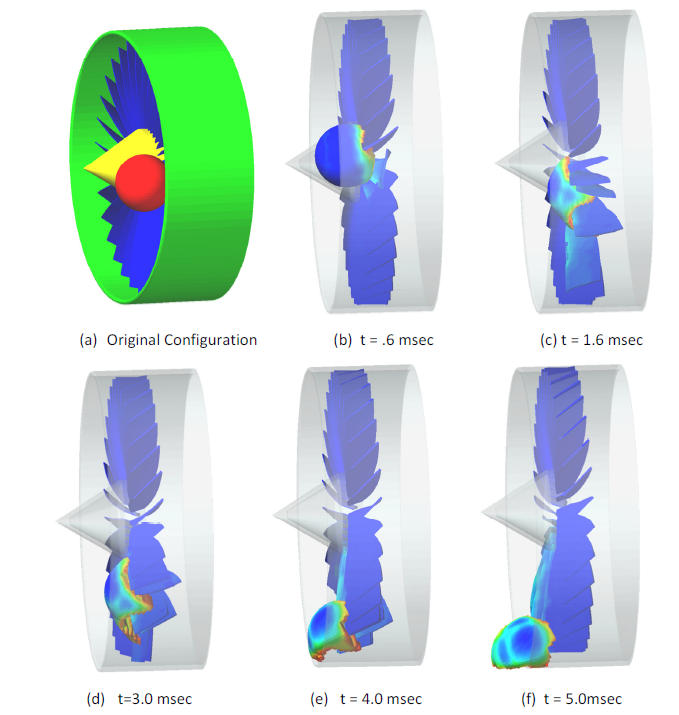

One of the most versatile features of the contact detection algorithm is that it will automatically rebuild the surfaces of the model as material erosion occurs and new surfaces are exposed due to element deletion. Figure 2 demonstrates a simulation of a bird strike on a turbine.
Figure 2: Example of Automatic Contact Tracking
The "bird" is modeled as a sphere comprised of a soft plastic material and it impacts the turbine at 300 mph. The turbine blades are steel and the turbine is spinning at 6000 RPM. The automatic contact monitors collision between the sphere and the blades, and also all of the blades with one another. The sphere and the blades are also monitored for contact with the outer shroud. The spherical bird has material deletion criteria based on plastic strain with a value of 30%. The steel turbine blades have material deletion criteria based on plastic strain of 100%.
As the sphere impacts the blades, the sphere heavily deforms and material erosion occurs. At each time step during the simulation, all of the contact surfaces are rebuilt automatically. Note the leading edge of the blades also experience erosion, so Autodesk Explicit is simultaneously rebuilding two eroding parts that are presently in contact. All of the collision detection and surface rebuilding is automatic and requires no user intervention.

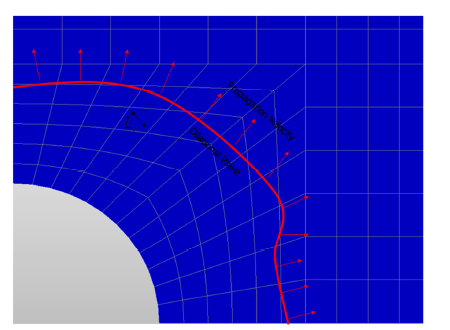

Figure 3 shows a sketch of a dilatational wave propagating across a non-uniform mesh.
Figure 3: Dilatational wave propagation in a mesh
Every element has some characteristic length that we show generically in the figure as x0007. Every element in the mesh knows its current value for the dilatational wave speed in the material at that point (the material wave speed can actually change in nonlinear material models). It does not matter where the wave is at any particular time. In fact, there are lots of waves running around the mesh! The explicit procedure simply computes the transit time across every element and takes a time step that corresponds to the minimum value over the entire model.
