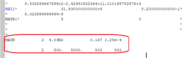

New Material for Explicit Analysis
MATB (Brittle Failure Material Model) is useful for analyses such as a projectile passing through concrete. The MATB card can be manually added to a Nastran file either in Inventor Nastran Editor utility or in Inventor Nastran file browser. For detailed information, see the MATB (Brittle Failure Material Model) topic.
