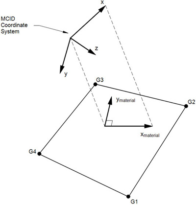

MCID Material coordinate system identification number. Integer ≥ 0 See Remark 7

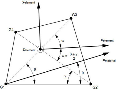

  2. Grid points G1 through G4 must be ordered consecutively around the perimeter of the element.
  3. All the interior angles must be less than 180°.

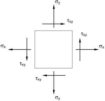

  4. Components of stress are output in the surface coordinate system. (See the SURFACE command in Section 3, Case Control.)

  7. If THETA/MCID is blank, field 5 of the PSHELL continuation entry will be used. If this field is also blank, then THETA = 0.0 is assumed when a non-isotropic material is referenced.

Figure 1. MCID Coordinate System Definition
Figure 2. CQUADR Element Geometry and Coordinate System

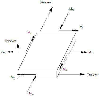

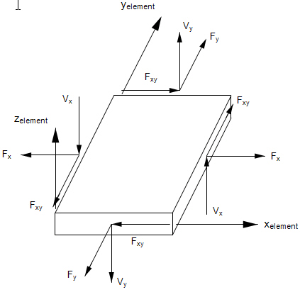

Figure 3. Forces and Moments in CQUADR Elements
Figure 4. Stresses in CQUADR Elements
