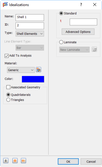

In the Model tree > Idealizations, right-click Shells > New.
  • Associated Geometry: Choose the face or faces to which you want to apply the Idealization properties. When the Associated Geometry option is NOT activated, the Idealization is applied to the entire model (all faces). Choose one of the following two radio buttons:
    • Quadrilaterals: Generate quadrilateral elements for all faces of all parts.
    • Triangles: Generate triangular faces for all faces of all parts.

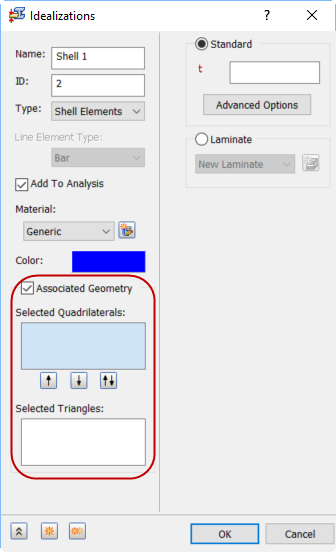

    Alternatively, activate the Associated Geometry option to define unique Idealization properties for individual faces within the part or assembly.
    Before selecting the faces…
    • Click in the Selected Quadrilaterals box, then select the desired faces. The selected faces are listed in the Selected Quadrilaterals box, and they will be meshed with quadrilateral shell elements.
    • Click in the Selected Triangles box, then select the desired faces. The selected faces are listed in the Selected Triangles box, and they will be meshed with triangular shell elements. This option is useful if you are creating a skin of shell elements on a face of a solid (tetrahedral) element part, so that the shell and solid meshes match.
    • Use the vertical arrow buttons to move selected items from one list to the other, or to swap the contents of the two boxes.
There are two main options available for shell elements: Standard and Laminate.
Standard Shells
  • Thickness (t): A shell element thickness that will be distributed equally on both sides of the surface.

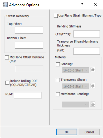

  • Advanced Options: Allows you to define the following additional properties for Standard shells.
    • Stress Recovery:Define top and bottom fiber distances for stress computation. It uses the right-hand rule and the order in which the grid points are listed on the connection entry to determine the positive direction.
    • MidPlane Offset Distance: Define the offset distance from the surface of grid points to the element reference plane. This can be visible when display cross section is on.
    • Use Plane Strain Element Type: This allows you to shift the regular shell element to Plane Strain Element. When this is checked the bending and membrane properties (like the ratio of transverse shear and membrane thickness) and respective material properties are disabled as they are not applicable.
    • Include Drilling DOF (CQUADR/CTRIAR): When this option is NOT activated, the shell elements support five degrees of freedom (DOF)—three translations and rotations about two in-plane axes (flexural distortion). The rotational DOF about the normal (drilling) axis is not directly supported. However, there is some stiffness included (as controlled by the parameter K6ROT).
      Activate the Include Drilling DOF (CQUADR/CTRIAR) option if you want to directly consider normal nodal rotations, or if you need to transmit moments about the axis normal to the plane of the element. Normal nodal moments produce in-plane translations of corner and midside nodes. The effect is typically more accurate when you include the drilling DOF. This option should be specified when:

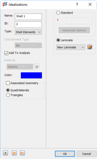

Laminate Shells
  • The Laminate option allows you to define a composite laminate property. Click on the New Laminate button. The Laminate Dialog opens up.
