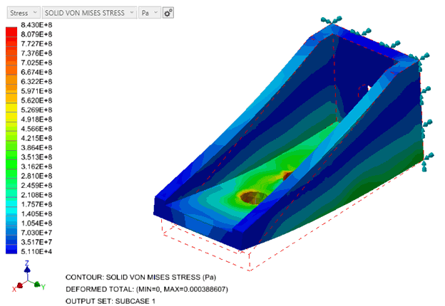

The Autodesk Inventor Nastran program is a finite element analysis pre- and post-processor embedded in a CAD environment as an Add-In. It is specifically tailored for designers and analysts as a tool for predicting the physical behavior of practically any part or assembly under various boundary conditions.
This easy-to-learn program allows designers to refine their designs without ever leaving its Windows environment by enabling them to analyze the response of parts/assemblies from within their CAD environment for given boundary conditions.

Autodesk Inventor Nastran also offers analysts a large range of solution capabilities, such as virtual simulation of structural, thermal, dynamics, and nonlinear problems.
