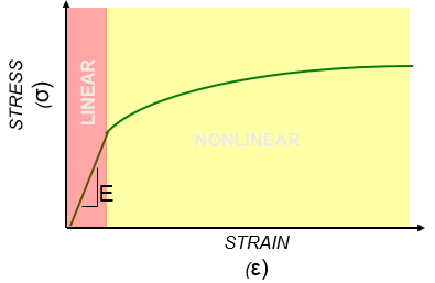

In a linear material model, the stress-strain relationship must be linear with a slope of E, Young’s Modulus (Hooke's law):
Material nonlinearity is a concern whenever the response at the operating loads causes strain levels in a material beyond the portion of the stress-strain curve that can reasonably be approximated as linear. Many materials have curves that deviate small amounts from linear for large amounts of strain so that, with all the other uncertainty in the model, there would be little value in a nonlinear material model. On the other hand, many curves deviate from linear almost immediately to such a degree that only the roughest trend studies can be made with a linear approximation.
The constant of proportionality in a linear material model is Young’s Modulus. This represents the slope of the linear portion of the stress-strain curve (see image below). For highly nonlinear materials, this modulus may only be applicable at very low strains.

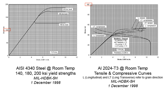

Stress-strain curves for metals are typically measured in tension or compression tests. The tensile test for metals is ASTM E8 and allows for multiple strain rates and material temperatures. The graphs below show stress-strain curves for 4340 Steel and 2024 Aluminum. You can see that the steel curves show a consistent slope, or Young’s Modulus until yield. The aluminum curve shows the variation in stress-strain response as different material orientations are examined. The curve also shows that 2024-T3 is asymmetric in that its tensile and compressive responses differ.
Both these curves were extracted from Mil Handbook 5H, a publicly available resource with a lot of good material reference data.

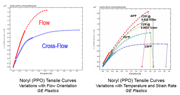

These curves below for Noryl, a GE Plastics PPO, were measured using ASTM D638, the standard tensile test for plastics. The curve on the left shows how the stress-strain relationship in plastics can vary with injection molding flow direction. The curves on the right show how the same material can have differing stress-strain responses at different strain, or loading, rates and temperatures.

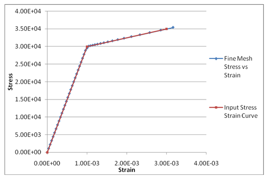

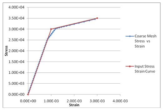

If an element undergoes a pure axial load, all Gauss points will yield at the same time, so the center stress will match the input stress-strain curve exactly. In the bending case, the outer Gauss points yield first then the inner points. This means the average center stress may not match the input stress-strain curve exactly during abrupt changes of slope on the input curve. This is because some Gauss points are on one point of the curve and the others are on another. If there is a large difference between the input stress-strain curve and the output stress results, a refined mesh is recommended.
The two images below show the stress-strain curves for two different mesh density. You can see how a finer mesh follows the input stress-strain curve more accurately.
It is also important to note that since the corner stresses are extrapolated from the Gauss points, their stress values can often exceed the stress values on the stress-strain curve. If there is a large difference between the center stress values and the corner stresses, it is recommended to refine the mesh to get a more accurate representation of the yielding that is occurring.
