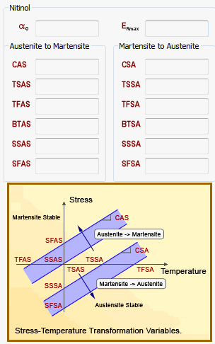

Nitinol
- This material property is used for shape memory alloys.
- It needs pressure coefficient
and maximum residual strain
. - The transformation stresses and temperature can be combined such that the transformation stress can be calculated by using the data specified for autensite to martensite and vice versa.
- Starting stress for transformation from austensite to martensite is SSAS -CAS*TSAS.
- Ending stress for transformation from austensite to martensite is SFAS -CAS*TFAS.
- Starting stress for transformation from martensite to austensite is SSSA -CSA*TSSA.
- Ending stress for transformation from martensite to austensite is SFSA -CSA*TFSA.
- Temperatures should satisfied relation:
TFAS<TSAS<TSSA<TFSA
- When BTAS and BTSA are zero, the material model is linear. When BTAS and BTSA are non-zero, the material model is exponential with BTAS and BTSA as coefficients.
