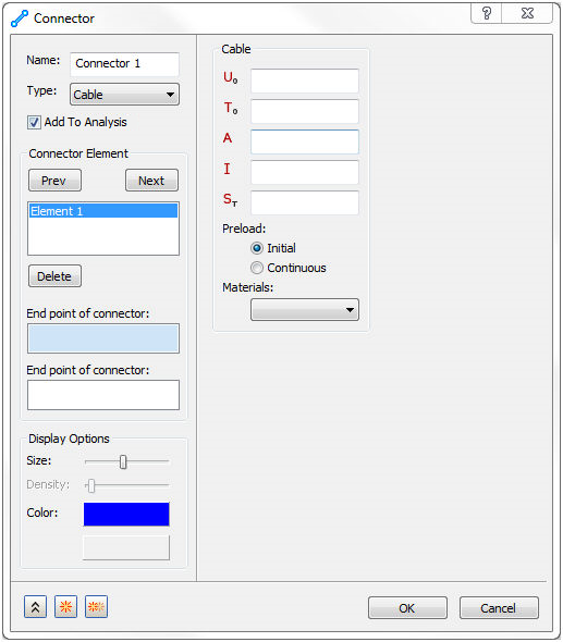

When selecting the Cable option under Type on the Connector form, the following sections are available:
  • Add To Analysis: This checkbox automatically puts this cable connector under Connectors in the current Analysis branch of the tree.
  • Connector Element: Allows multiple cable elements to be defined within the current Connector Name.
    • You select two end points of the connector.
  • Display Options: Allows you to edit the display options of the cable connector.
  • : Defines the initial cable slack.
  • : Defines the initial cable tension.
  • : Defines the cross sectional area of the cable.
  • : Defines the moment of inertia of the cable.
  • : Defines the allowable tensile stress of the cable.
  • Preload:
    • Initial: This option tells the solver that is the initial preload of the cable.
    • Continuous: This option tells the solver that is the actual tensile load and remains constant.
  • Materials: Must select a material from the drop-down list.
