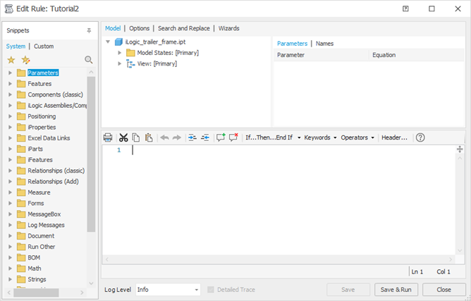

  2. On the Rules tab, right click in the white space and choose Add Rule.
  3. Name the rule Tutorial 2 and click OK. This will open the new rule in the Edit Rule dialog which we’ll use in the steps that follow to build our model.
    The iLogic rules are created in Visual Basic language. The first set of commands we’ll add will define the external iLogic rules and Inventor Nastran add-ins.
  4. Copy the following text:
    AddReference "NINIlogic"
    Sub Main()
    	   iLogicVb.RunExternalRule("IlogicExtRule_EnterInCADEnv")
    	   Dim AddinObj As New NINIlogic.InCadAddin
    	   Dim strCmdForNewMaterial, strCmdFornewIdealization As String
  5. Paste the text into the text field of the Edit Rule dialog.
  6. Press the Enter or Return key twice to jump down to a new line.
