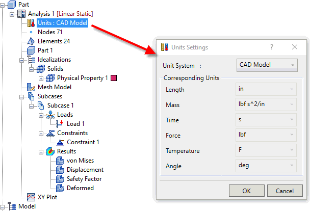

Once the units are defined, they will show up in the tree under Analysis, and you can edit the unit system from there, as shown in the following image.
