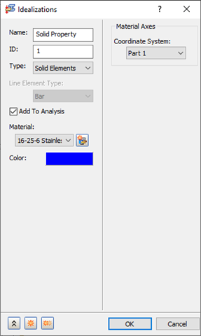

  12. In the Model tree, under Idealizations, right-click Solids and select New.
  13. In the Idealizations dialog, type Solid Property for Name, select Solid Elements under Type, and ensure that Material is set to 16-25-6 Stainless Steel.
  14. Then click OK. Solid Property is added to the Idealizations list.

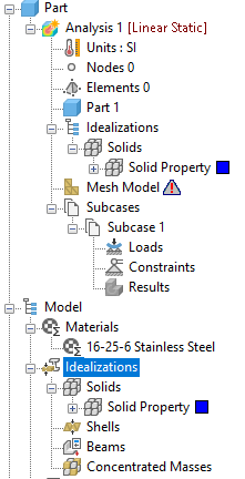

    The tree view should now look as shown below.
