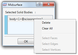

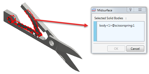

- Click one or more bodies to select them for conversion to midsurfaces. Each one you click is listed in the
Selected Solid Bodies box.
- You can right-click items to
Delete them from the list, preventing their conversion to midsurfaces. Use the
Clear All command to remove all solid bodies from the list. You can also graphically select bodies to convert to midsurfaces, adding them to the list.

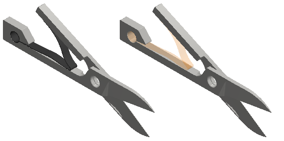

The following images compare a CAD model before and after using the Find Thin Bodies command. The solid spring on the left is replaced by the midsurface spring on the right:
