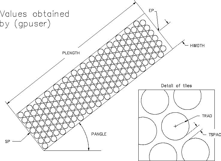

The gpuser subroutine prompts the user for information necessary to draw a garden path.
In this subroutine, you use the user input methods of the Utility object and calculate values used to create the geometry for the outside edges of the path.

The following illustration shows how the values within the gpuser subroutine are obtained or calculated for the garden path.
