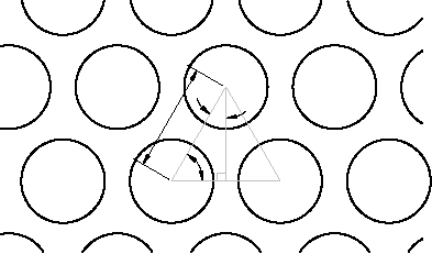

The drow subroutine draws only a single row of circular tiles, but can be used with a While loop to repeatedly draw all the circular tile rows. Tiles in adjacent rows form equilateral triangles, as shown in the previous illustration. The edges of these triangles are equal to twice the tile radius plus the spacing between the tiles. Therefore, by trigonometry, the distance along the path between rows is the sine of 60 degrees multiplied by this quantity, and the offset for odd rows is the cosine of 60 degrees multiplied by this quantity.
An If statement is used to force the offsetting of every other row. If the offset variable is equal to 0, set it to the spacing between the centers of tiles multiplied by the cosine of 60 degrees, as explained earlier. If the offset variable is not equal to 0, set it to 0. This alternates the offset on the rows as you want.
