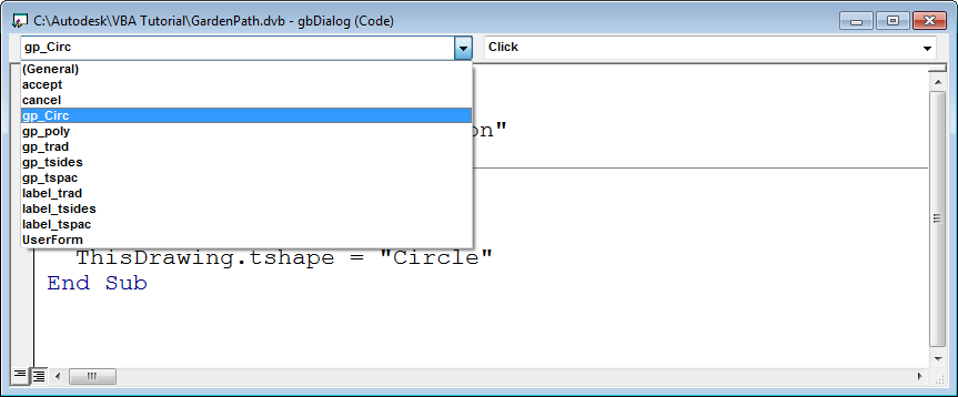

- On the Project window, right-click the gpDialog user form and click View Code.
- In the Code window, click the Objects drop-down list on the left and select gp_poly.
- In the Procedure drop-down list, select Click if it is not selected by default.
- In the Private Sub gp_poly_Click procedure that is added, enter the following code statements:
gp_tsides.Enabled = True ThisDrawing.tshape = "Polygon"
The code enables the gp_tsides text box and sets the tshape variable of the ThisDrawing module to the text string Polygon.
- Add the Click procedure for the gp_circ object and enter the following code statements:
gp_tsides.Enabled = False ThisDrawing.tshape = "Circle"
The code disables the gp_tsides text box and sets the tshape variable of the ThisDrawing module to the text string Circle.

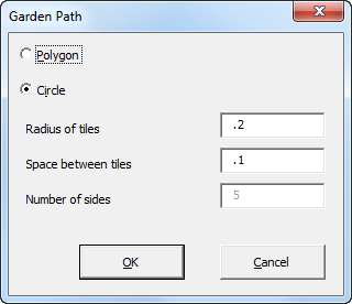

- Add the Click procedure for the accept object (OK button):
Private Sub accept_Click() If ThisDrawing.tshape = "Polygon" Then ThisDrawing.tsides = CInt(gp_tsides.text) If (ThisDrawing.tsides < 3#) Or (ThisDrawing.tsides > 1024#) Then MsgBox "Enter a value between 3 and " & _ "1024 for the number of sides." Exit Sub End If End If ThisDrawing.trad = CDbl(gp_trad.text) ThisDrawing.tspac = CDbl(gp_tspac.text) If ThisDrawing.trad < 0# Then MsgBox "Enter a positive value for the radius." Exit Sub End If If (ThisDrawing.tspac < 0#) Then MsgBox "Enter a positive value for the spacing." Exit Sub End If GPDialog.Hide End Sub
This code tests whether the user choose polygon as the tile shape and specified a valid number of sides for the polygon. The radius and spacing values entered in the text boxes are saved to the variables trad and tspac. Conditional statements are also used to make sure the values of trad and tspac are not 0.
After the values are obtained and verified, the gpDialog.Hide statement hides the form, passing control back to the subroutine that first called the form.
- Add the Click procedure for the cancel object (Cancel button):
Private Sub cancel_Click() Unload Me End End Sub
This event handler unloads the form and terminates the entire macro.
- Add the Initialize procedure for the UserForm object:
Private Sub UserForm_Initialize() gp_circ.Value = True gp_trad.Text = ".2" gp_tspac.Text = ".1" gp_tsides.Text = "5" gp_tsides.Enabled = False ThisDrawing.tsides = 5 End Sub

- In the Garden Path dialog box, click Polygon.
- In the Radius of Tiles text box, enter .5.
- In the Space Between Tiles text box, enter .05.
- In the Number of Sides text box, enter 8.
- Click OK.
