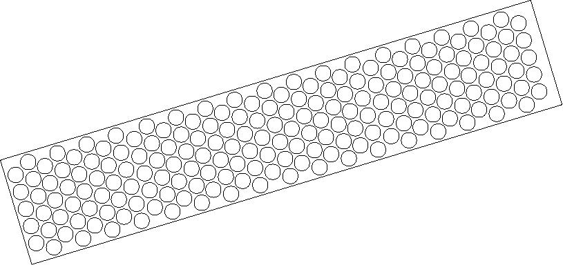

Developing an AutoLISP® program begins with an idea for automating some aspect of AutoCAD®. It may be a need to speed up a repetitive drafting function, or to simplify a complex series of operations. For the tutorial, the garden path you want your program to draw is a complex shape with a variable number of components, based on initial input from the user. Here's what it will look like:
Your program must do the following to draw the garden path:
  • Given a start point, an endpoint, and a width, draw a rectilinear boundary. The boundary can be at any 2D orientation. There should be no limit on how large or small it can be.
  • Prompt the user for tile size and tile spacing values. The tiles are simple circles and will fill the boundary but must not overlap or cross the boundary.
  • Place the tiles in alternating rows.
