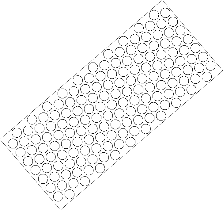

- At the Specify start point of path: prompt, enter 2, 2.
- At the Specify endpoint of path: prompt, enter 9, 8.
- At the Specify half width of path: prompt, enter 2.
- At the Specify radius of tiles: prompt, enter .2.
- At the Specify spacing between tiles: prompt, enter .1.
The specified values should result in a garden path as shown in the following figure:
