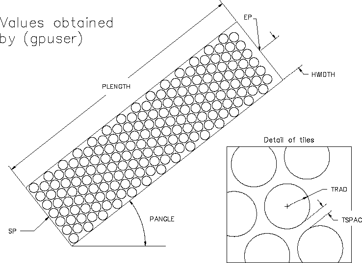

The following illustration shows how the values within the gpuser subroutine are obtained or calculated for the garden path.
