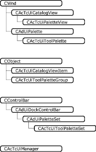

The following figure shows the Tool Palette UI class hierarchy.
