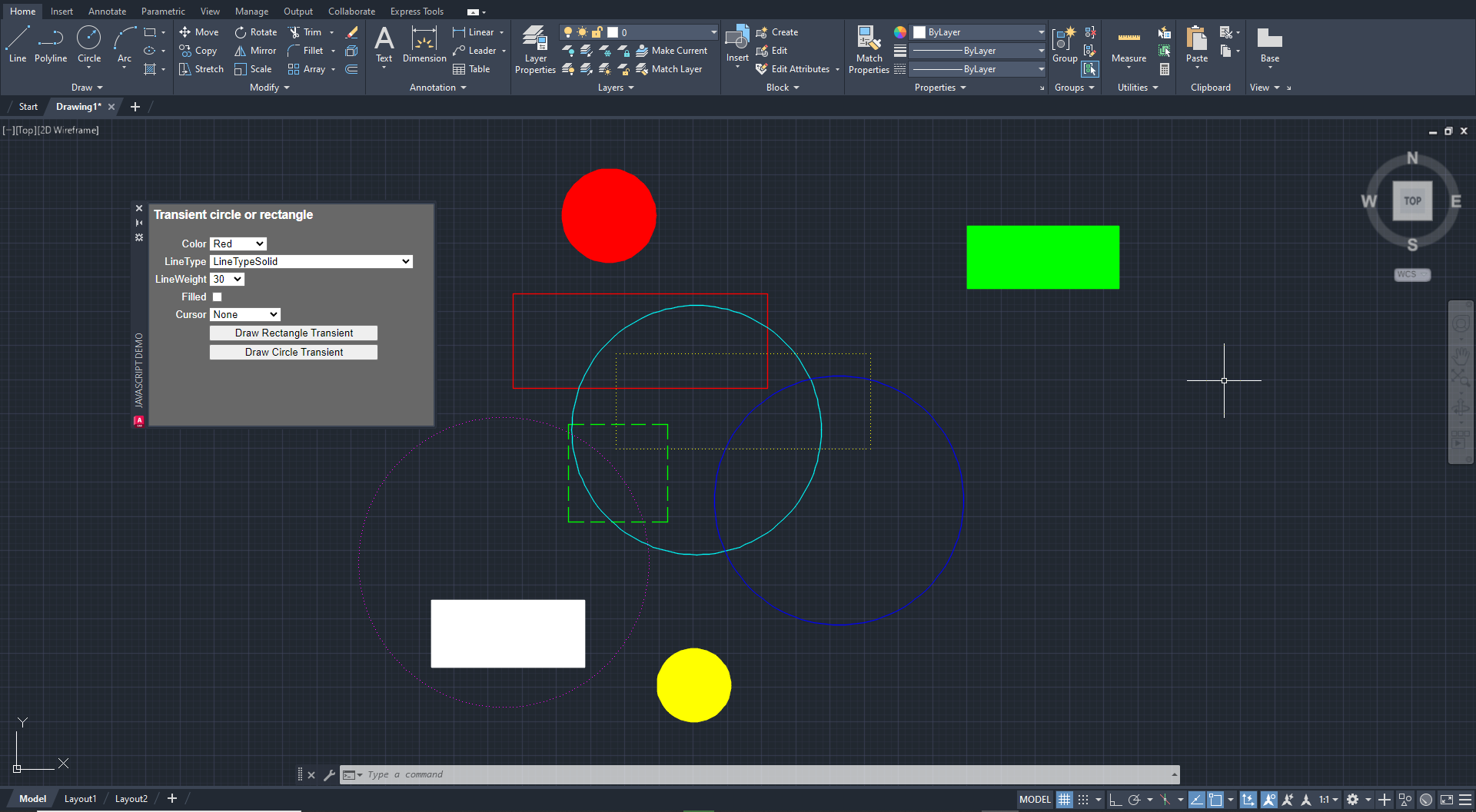

To Implement an AutoCAD Palette
This AutoCAD JavaScript tutorial demonstrates how to implement a palette with HTML5 and implement user interactions with JavaScript to perform tasks like drawing a transient rectangle or circle in AutoCAD.
This AutoCAD JavaScript tutorial demonstrates how to register a new transparent command and zoom to the extents of a selected object.
In this tutorial you will,
  • Register a custom command in Manasged .NET with C#
  • Load a HTML5 file into a palette
  • Draw transient graphics; rectangle and circle using the getExtents function
  • Zoom to the extents of the selected object with zoomExtents function
  1. Use the following HTML5 and JavaScript code to create the commands (JavaScript functions) that are invoked when you click a button on the palette and the various selection methods:
<html>
<head>
    <title>Draw a transient circle or rectangle</title>
    <script type="text/javascript" src="https://df-prod.autocad360.com/jsapi/v4/Autodesk.AutoCAD.js"></script>
    <script type="text/javascript">

        <h3>Transient circle or rectangle</h3>
    <table border="0">
        <tr>
            <td align='right'>Color</td>
            <td>
                <select id='ColCB'>
                    <option selected="selected">Red</option>
                    <option>Yellow</option>
                    <option>Green</option>
                    <option>Cyan</option>
                    <option>Blue</option>
                    <option>Magenta</option>
                    <option>White</option>
                </select>
            </td>
        </tr>
        <tr>
            <td align='right'>LineType</td>
            <td>
                <select id='LTCB'>
                    <option selected="selected">LineTypeSolid</option>
                    <option>Dashed</option>
                    <option>Dotted</option>
                    <option>Dash_Dot</option>
                    <option>Short_Dash</option>
                    <option>Medium_Dash</option>
                    <option>Long_Dash</option>
                    <option>Short_Dash_X2</option>
                    <option>Medium_Dash_X2</option>
                    <option>Long_Dash_X2</option>
                    <option>Medium_Long_Dash</option>
                    <option>Medium_Dash_Short_Dash_Short_Dash</option>
                    <option>Long_Dash_Short_Dash</option>
                    <option>Long_Dash_Dot_Dot</option>
                    <option>Long_Dash_Dot</option>
                    <option>Medium_Dash_Dot_Short_Dash_Dot</option>
                    <option>Sparse_Dot</option>
                    <option>Solid_6_Pixels_Blank_6_Pixels</option>
                </select>
            </td>
        </tr>
        <tr>
            <td align='right'>LineWeight</td>
            <td>
                <select id='LWCB'>
                    <option>0</option>
                    <option>5</option>
                    <option>9</option>
                    <option>13</option>
                    <option>15</option>
                    <option>18</option>
                    <option>20</option>
                    <option>25</option>
                    <option selected="selected">30</option>
                    <option>35</option>
                    <option>40</option>
                    <option>50</option>
                    <option>53</option>
                    <option>60</option>
                    <option>70</option>
                    <option>80</option>
                    <option>90</option>
                    <option>100</option>
                    <option>106</option>
                    <option>120</option>
                    <option>140</option>
                    <option>158</option>
                    <option>200</option>
                    <option>211</option>
                </select>
            </td>
        </tr>
        <tr>
            <td align='right'>Filled</td>
            <td><input type='checkbox' id='Filled' /></td>
        </tr>
        <tr>
            <td align='right'>Cursor</td>
            <td>
                <select id='Cursor' title='Cursor to be displayed on hover'>
                    <option selected="selected">None</option>
                    <option>None</option>
                    <option>Arrow</option>
                    <option>Ibeam</option>
                    <option>Wait</option>
                    <option>Cross</option>
                    <option>UpArrow</option>
                    <option>SizeNWSE</option>
                    <option>SizeNESW</option>
                    <option>SizeWE</option>
                    <option>SizeNS</option>
                    <option>SizeAll</option>
                    <option>No</option>
                    <option>Hand</option>
                    <option>AppStarting</option>
                    <option>Help</option>
                </select>
            </td>
        </tr>
        <tr>
            <th>&nbsp;</th>
            <td>
                <input type='button' style="width: 220px" onclick='drawRectangularTransient()'
                       value='Draw Rectangle Transient' />
            </td>
        </tr>
        <tr>
            <th>&nbsp;</th>
            <td>
                <input type='button' style="width: 220px" onclick='drawCircularTransient()'
                       value='Draw Circle Transient' />
            </td>
        </tr>
    </table>
</body>
</html>

  3. Compile the project and load the resulting DLL assembly into AutoCAD.
  4. At the AutoCAD command prompt, enter jsp.
    The "Sample Palette" should now be displayed in AutoCAD. Specify the options for the rectangle or circle transient object to be drawn, and then click the appropriate button to draw the object.
    New Palette in AutoCAD using JavaScript and HTML image
