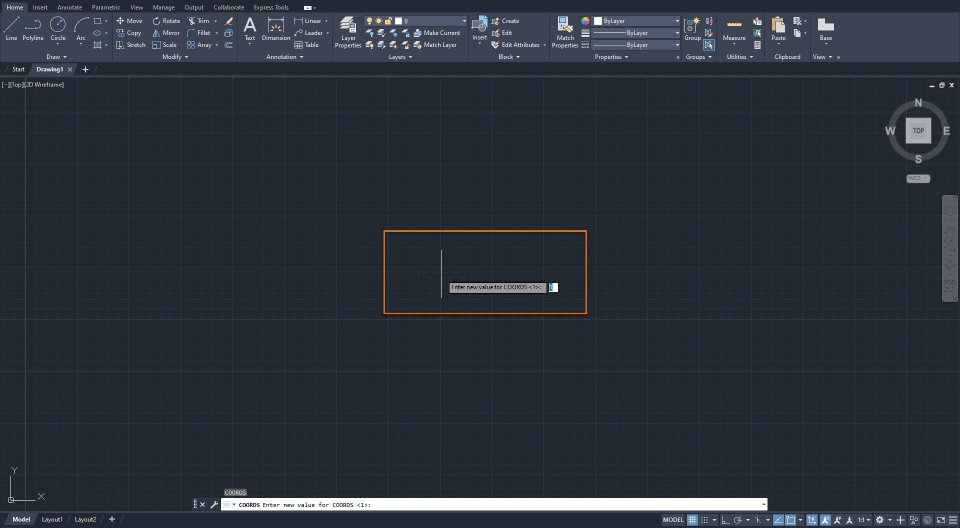

  6. At the AutoCAD command prompt, enter coords. Press Enter after you verified the value has changed.
    The system variable value should now be set to 1.
    Setting COORDS system variable value using JavaScript image
