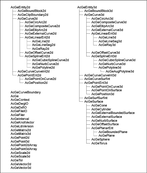

The class hierarchy for the AcGe library is shown as follows:
