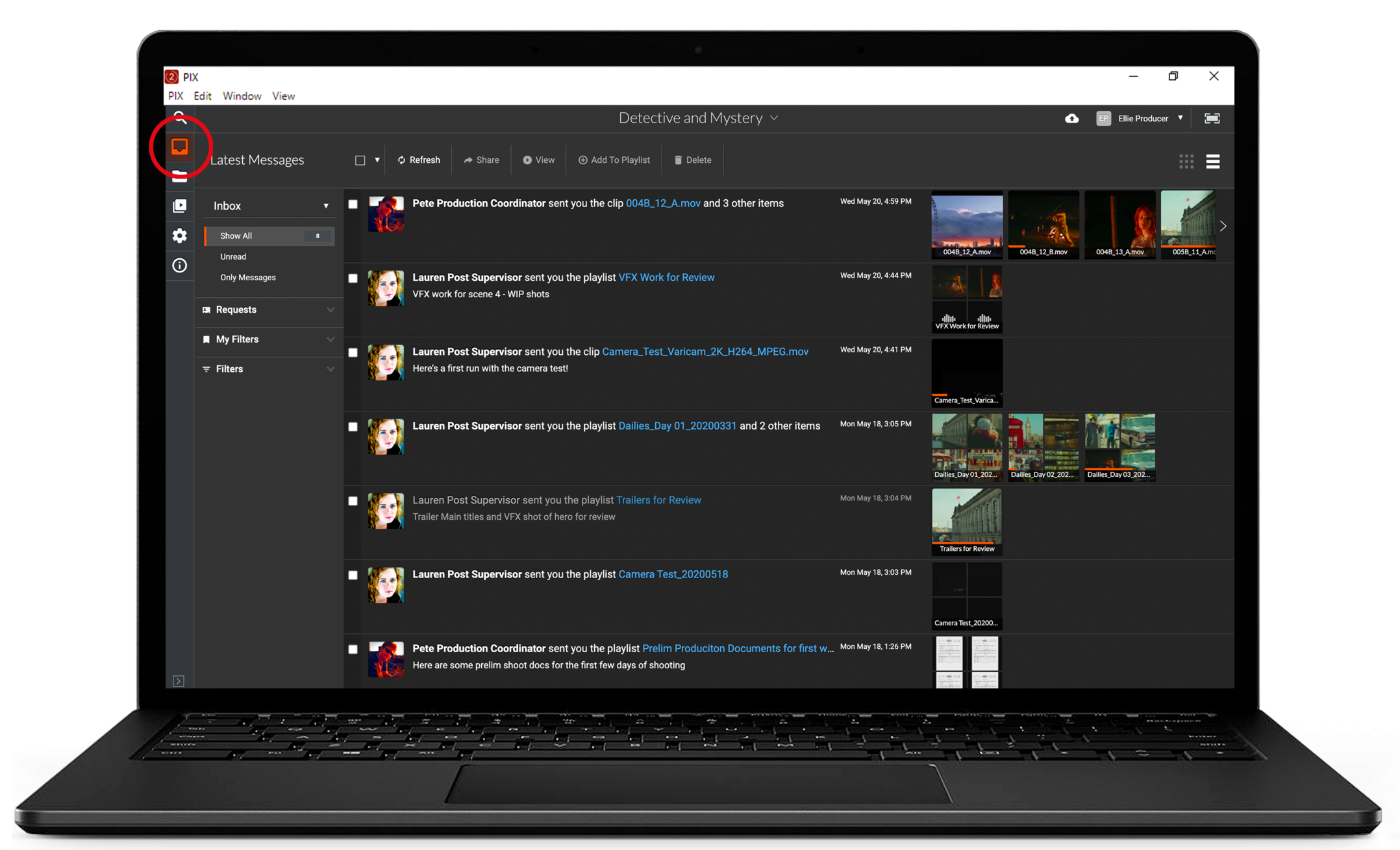

Receive media sent by others
The PIX Inbox functions in the same way an email inbox would. It will house all content that has been specifically sent to that user. Users will be able to view content directly from their inbox and, if their permissions permit it, send that content on to other users on that same project.
Inbox access is the most basic level of access a user can have on PIX. Everyone who is added to a PIX project will have their own PIX Inbox.
See what's in your Inbox
New or unread messages will appear with white text. Read messages will have grey text. The messages will be ordered from newest to oldest.
To refresh your Inbox, click Refresh in the top toolbar.
Adjust your Inbox View
If you would like to switch your Inbox’s layout to Thumbnail view: Select the Thumbnail view icon in the top right corner of the window. Note that when in thumbnail view, your message feed will disappear. Click the list icon to go back to the list view.

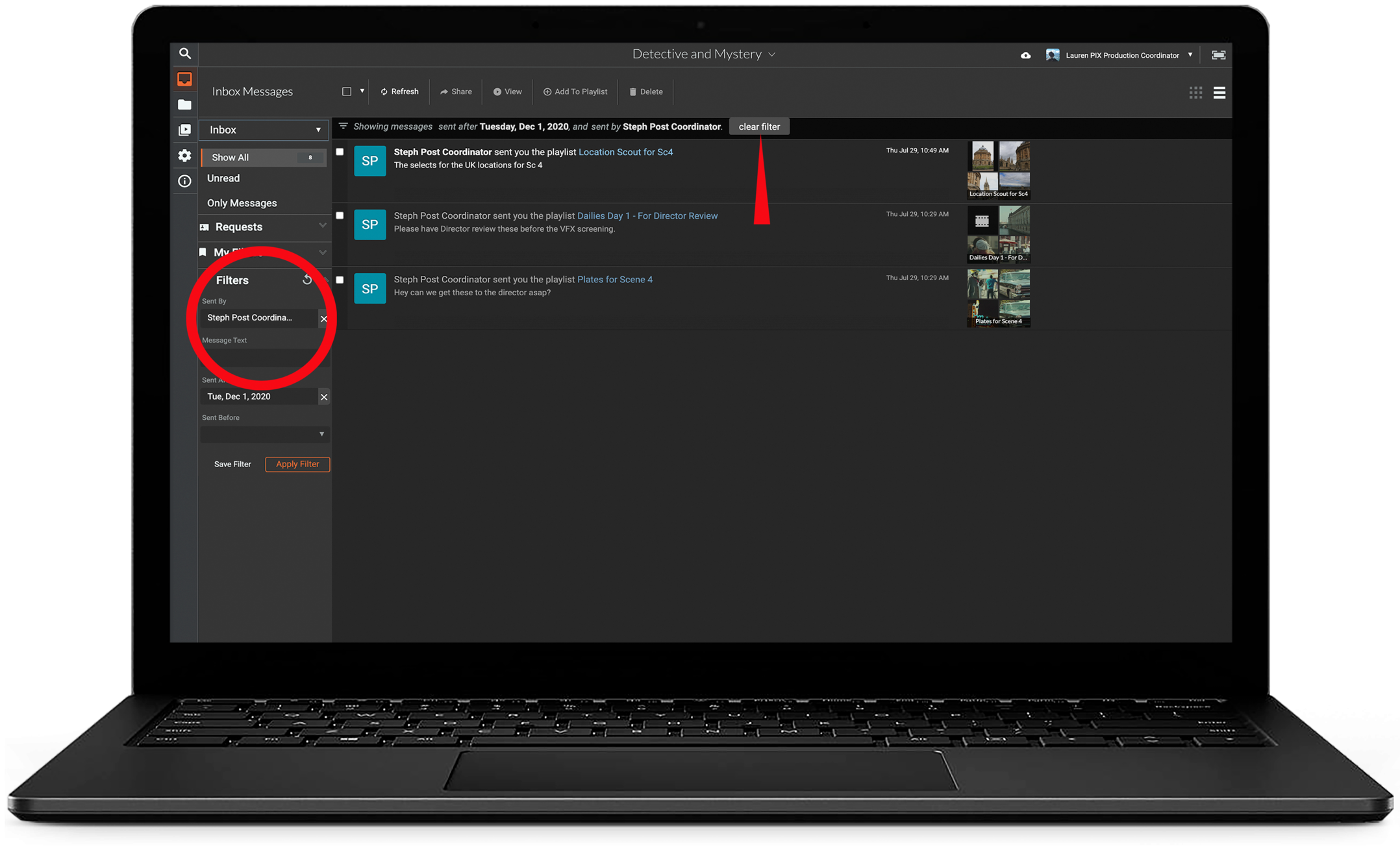

Use custom filters to search your Messages
Below the Inbox section, you will see My Filters and Filters. You can create and save filters based on certain parameters and use these filters to toggle the messages that are visible in your feed.
For example, you may want to set up a filter for all sends from a particular user on the project, or sends that you received between a certain date range.
To use an existing filter, expose it under My Filters by hitting the dropdown arrow, and selecting the desired filter from the list. To clear the filtered messages in your Inbox, click Clear Filter at the top of the message feed.

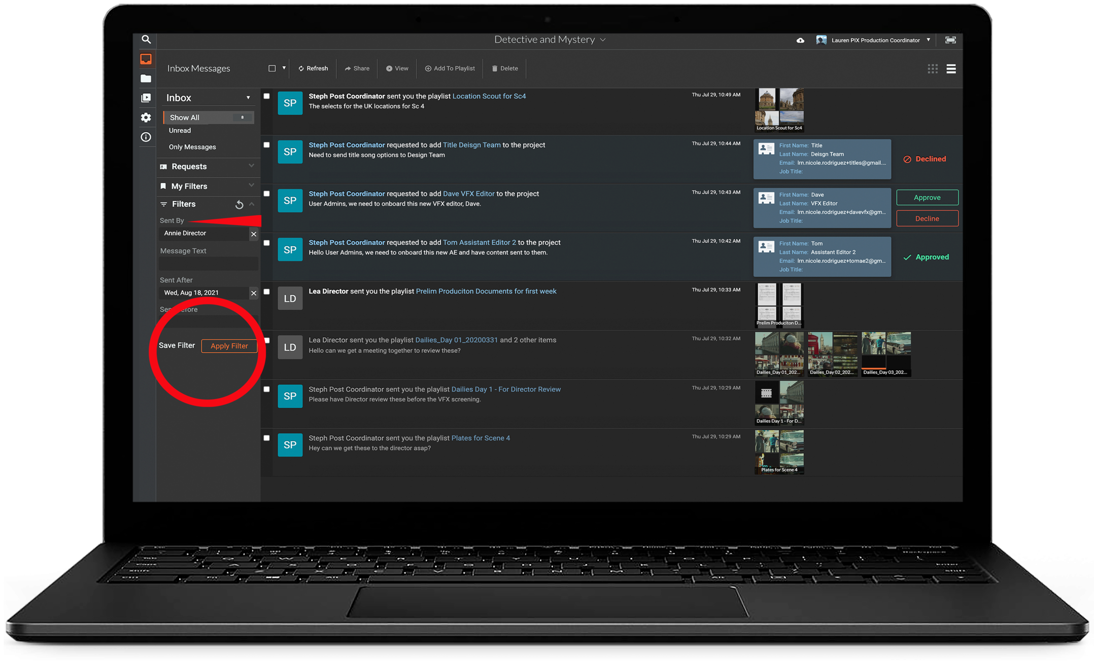

Create a custom Inbox filter
To create a new filter:
  1. Click Filters
  2. Enter the criteria you need to search by. You don’t have to fill them all in, but at least one parameter must be set in order to create the filter. The options are:
    • Sent By
    • Message Text
    • Sent After
    • Sent Before
  3. If you need to clear the criteria and reset it differently while you’re in the filter creation window, hit the refresh circle in the top right corner.
  4. Click Apply Filter to perform the search, then Save Filter if you would like to save it to your My Filters section.
Once you have saved a filter, you cannot edit its criteria, only its name.
To delete or edit the name of a saved filter, select it and click the pencil on the left to edit the name or the trash icon on the right to delete it.
