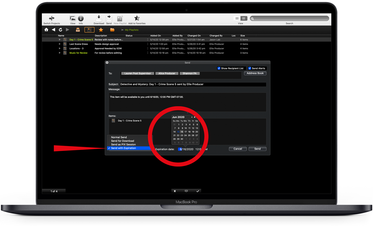

*To share with an expiration: *
- Select the Playlist you wish to share.
- Click the Send button in the top toolbar, or right-click and select ‘Send’.
- The send window will appear.
- Enter recipients, a subject, and a message.
- Select Send with Expiration in the pulldown menu in the bottom left-hand corner of the send window.
- Select a date you would like the content to expire using the calendar.
- Enter a date and time you would like the content to expire using the HH:MM format. (Note: the time will respect the timezone you are in).
