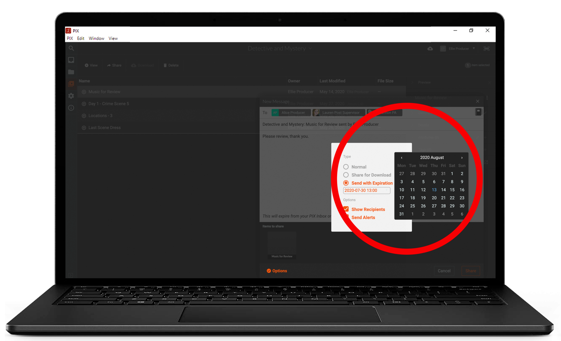

To share with an expiration:
- Select the Playlist you wish to share.
- Right-click and select Share, or click Share from the top menu.
- The New Message will appear.
- Enter recipients, a subject, and a message.
- Select Options in the bottom left-hand corner of the send window and choose Send with Expiration.
- Click the date/time field and choose a date and then a time from the calendar for the content to expire. You can also manually type in a date/time. (Note: the date/time will respect the timezone you are in).
- Click anywhere to move out of the Options window, and then hit Share to send the content.

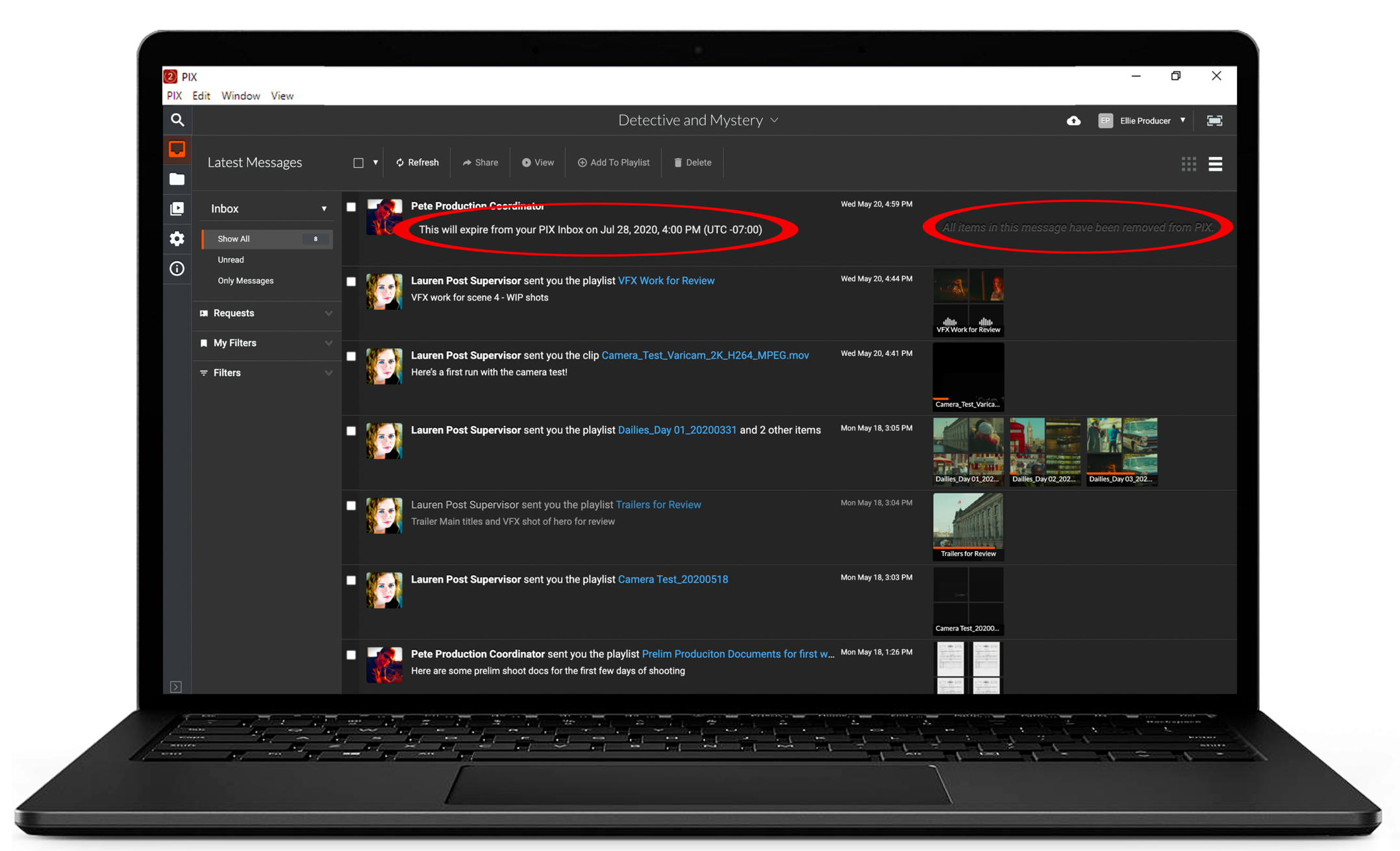

In the Recipient's Inbox
Once the expiration for the content has completed, the recipient will still see the message in their PIX for Browser and PIX for Windows inboxes.
The expiration date/time will still be visible under the sender's name, and to the right, there will be a message stating that All items in this message have been removed from PIX.
