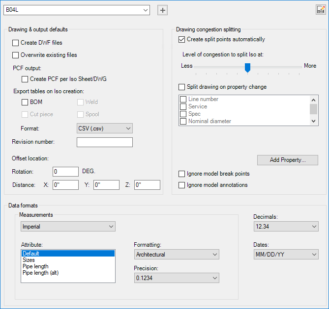

Iso Style Default Settings
Sets defaults for the Advanced Iso Creation Options.
You can set defaults for the advanced options specified when you run a production Iso or a quick Iso. This allows you to easily specify the same advanced options for each Iso in a project.
Drawing & Output Defaults
Advanced Iso Creation Options dialog box
Drawing Congestion Splitting
Data formats (Mixed Metric)
Applies to mixed-metric projects.
Measurements
Specifies the unit of measure (imperial or metric units).
Attribute, Formatting, Precision
Sets formatting and precision for attribute, annotation, and bill of material text. You can specify a different format for Sizes and Pipe Length.
Decimals
Sets the decimal delimiter (period, comma, or space).
Dates
Sets British, European, or American format for date display and the number of digits in the year.
