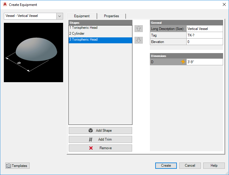

  3. Click Add to add available shapes for this equipment type. Use the Up and Down arrows to change the position of the shapes.
  4. Under General, do the following:
    • (Optional) To assign a tag to the equipment, click in the Tag box. In the Assign Tag dialog box, in the Type box, enter a type (for example: V for Vessel). In the Number box, enter a unique numeric identifier. Click Assign.
    • To assign a description for this piece of equipment, in the Long Description box, enter a description (for example: Vessel-Custom).
    • To assign an elevation (the vertical distance from the insertion point to the bottom of the first shape), in the Elevation box, enter a value.
  5. Under Shapes, click a shape. Under Dimensions, enter dimension values. Repeat this step for each shape dimension you want to change.

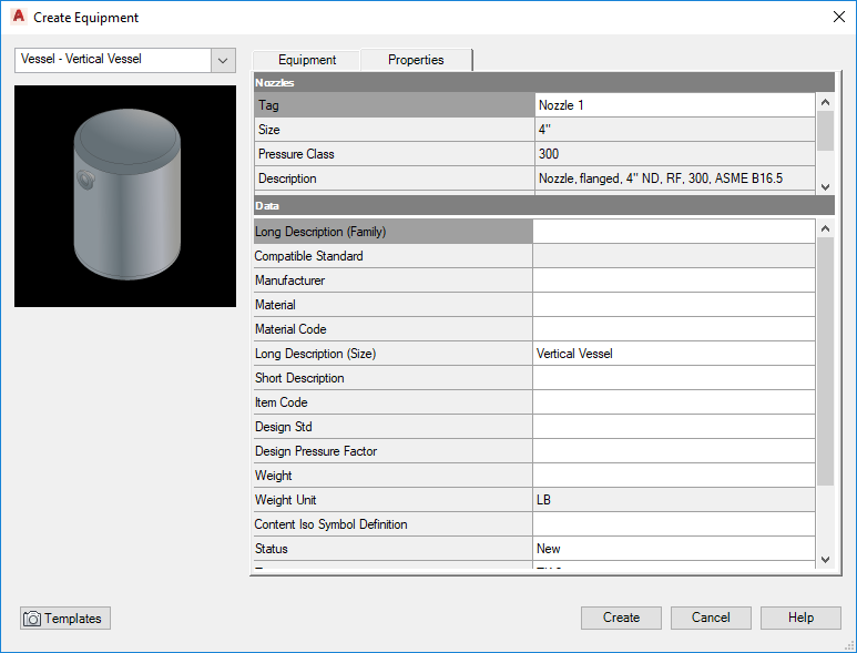

  6. On the Properties tab, add relevant data for items (such as Manufacturer, Material, Size, and so on).
